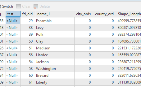

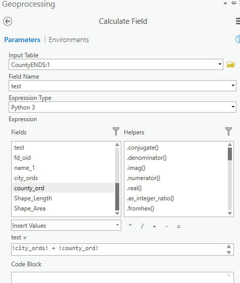

I am doing this now in a geodatabase and am verifying that the fields are all of the type numeric. From the screenshot below you can see the zeros in the table. There are some 1's further down in the table.
Here is the setup I do:
setting up expression
Here is the result of the table
result

DanPatterson_Retired
MVP Emeritus
Is this a joined table?
CountyENDS:1 is a strange table name
you fields are out of order so that might be due to a join unless you rearrange things
Something is amiss.
I would copy those values to new fields (ie make a new field and do the newfield = oldfield thing), so that you have a clean file without joins (if indeed you have them) since you can only calculate values in the destination table, and not the table that you are joining over.
