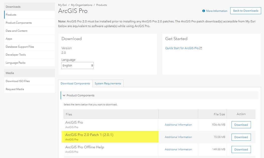

George_Thompson
Esri Notable Contributor
Here is a screenshot of where to download the Pro 2.0.1 update.
--- George T.
AnnVanSlembrouck
Very helpful - thanks!
