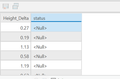

hello, i want to calculate feild using phyton if function to do the following :
if Height_Delta is greater than 0 write in the status cell " Uprise"
if Height_Delta is less than 0 write in the status cell "Downrise"
image is attached
can anyone can help with the code ?
thanks.

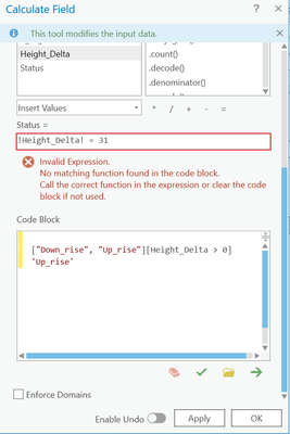

matu89
can u tell where to write each line of the code in the feild calculator window ?
image is attached here :
 thank u
DanPatterson
MVP Esteemed Contributor
["Down_rise", "Up_rise"][!Height_Delta! > 0]
goes under Status =  line
not in the code block
some background
Fundamentals of field calculations—ArcGIS Pro | Documentation
... sort of retired...
