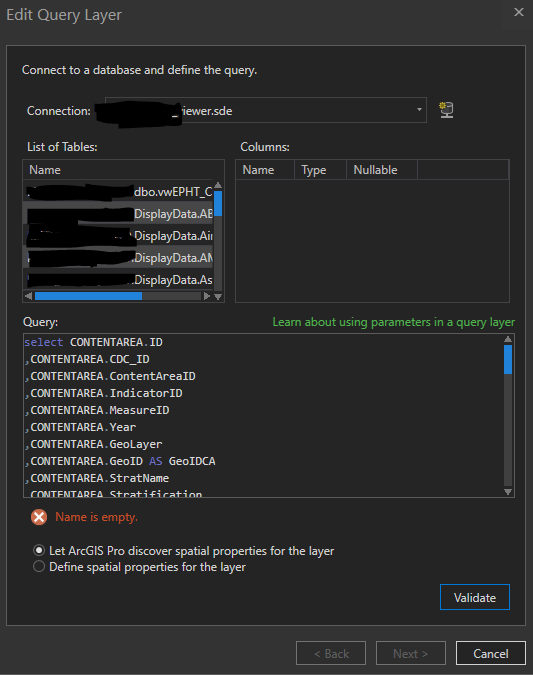

This is more of a discussion question than a "help me find the right answer" question. I'm looking for others with experience using query layers in Pro. I don't use them a lot, but it's the right solution for a project currently under development. For context, I have Pro 2.8.1 installed on a Windows 10 64-bit machine. The query layers are pulling from SQL Server (currently using version 18) and I'm writing the queries on the ArcGIS Pro side rather than in SQL Server Management Studio.
With regard to "buggy" issues, I've noticed several undesirable, yet inconsistent behaviors when updating a query.
- When I click the edit button to modify the query, the option to name the Query is not available. Most of the time that's not a problem. Occasionally, it will prevent me from saving my updates because I get an error message that says that the name is empty (it's not, but Pro seems to think it is). **EDITED TO ADD screenshot:
