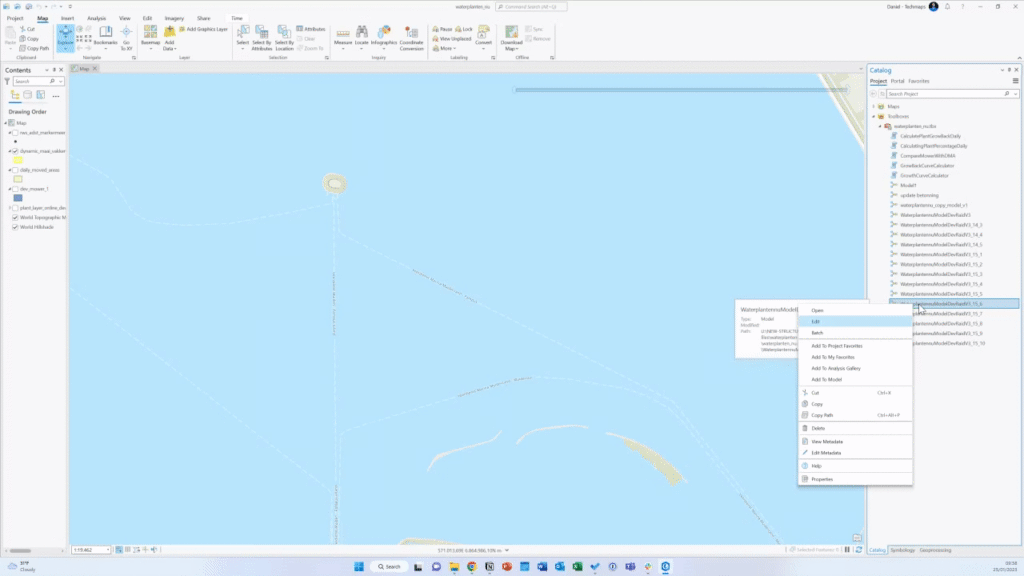

Hello,
I am using ArcGIS Pro v3.0.3
I have encountered a bug with the model builder in ArcGIS Pro. I wonder if anyone else has experienced similar issues and if there are any solutions to this bug.
The bug is that the “Auto layout” option in model builder ribbon is automatically applied to my model when I open it in edit mode from the toolbox database.
This auto layout functionality messes up the positions of all the geoprocessing tools and nodes within the model.
This issue started to occur after I upgraded to windows 11 business with Azure and linked a external HDD, Specifically after i changed a setting in windows the setting was called "SMB 1.0/CIFS File Sharing Support" I have since reverted the setting back but the issue still persists
If anyone can help me with this bug that would be much appreciated.
Kind regards,
Daniel
