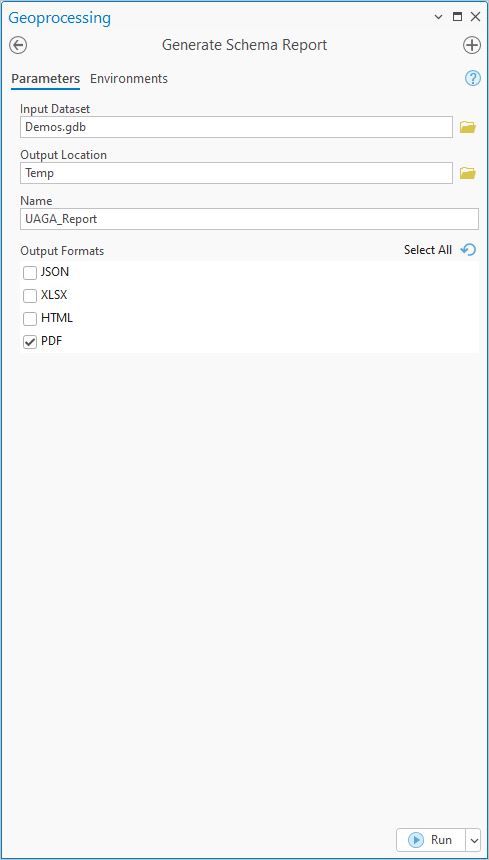

So even though the Generate Schema Report GP tool parameter says - Input Dataset - it will take an entire geodatabase and generate the report for EVERYTHING in that GDB.  I tested this where I selected Demo.gdb as the input dataset and generated a pdf with the full report.

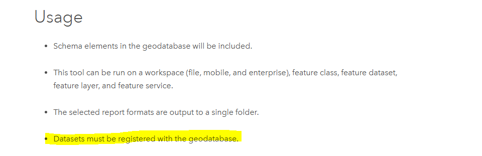

Are there any means to get a Schema Report from an UNregistered, non-eGDB, just a plain FGDB--I see in the notes that it has to be registered and that has changed recently, as a few months ago, it would work on unregistered FGDB, just looking for a means out side a  registed eGDB
Robert_LeClair
Esri Esteemed Contributor
Good afternoon Lauralee!  So I examined the help documentation back to ArcGIS Pro 3.2 and the pages say that the datasets must be registered with the geodatabase.  So I don't think there's been a change recently in the code.

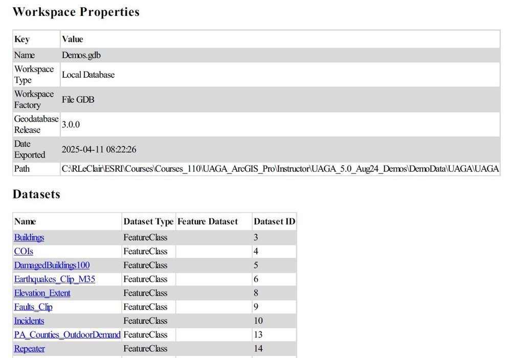

@LauraleeGann25 - so I can confirm that the Generate Schema Report does work on a fGDB as I just ran it without any issues.  See images below.  The item "datasets must be registered with the geodatabase" only applies to eGDB's and not fGDB's.  In eGDB's, when a dataset is registered with the geodatabase, this stores information about the items in the repository system tables.  My guess is that help documentation for this item could be improved.  Question - are you not able to run the GP tool on your fGDB?  If it does not run, then maybe you need to upgrade the fGDB to the current release.

@LauraleeGann25 Thanks for referencing the Generate Schema Report documentation. Note the following:
  • This tool can be run on a workspace (file, mobile, and enterprise), feature class, feature dataset, feature layer, and feature service.
Have you tried a FGDB as input dataset and tool failed or errored? If so, post the error. As posted by @Robert_LeClair  and myself, we have run the tool on FGDB with a schema report output.

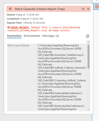

I am facing an error with the Batch Generate Schema Report.  The EGDB that I want to run the report for is very large.  When I generate a report on the entire database, the output files are over 20 GB (all the output types were large) and are very laggy to work with.  When I run the report as a batch on just the key feature datasets, the tool errors out after outputting the first feature dataset.  It does actually generate an output, the report opens fine and just the first dataset listed.
