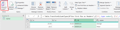

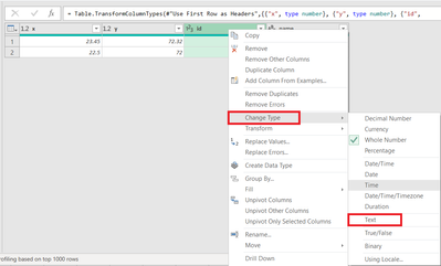

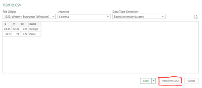

One can also use MS Excel?
1. Open a blank Excel Sheet. Go to Data tab > From Text/ CSV.
2. Select the CSV > Click Import
3. In the new dialog box, click Transform Data. You may choose "Tab" for Delimiter, if required.
4. In "Transform Data" dialog box, right-click the field (you want the leading zeros), > Change Type > Text.
Click "Replace Current" for Change Column Type.
5. Click Close and Load.
6. Save the Excel file.
7. In ArcGIS Pro, execute Excel to Table.

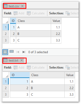

For example, consider two test files, one comma and one tab delimited, each with with one attribute with leading zeros:
MicZatorsky_AEC_0-1637871687037.pngMicZatorsky_AEC_0-1637871687037.pngMicZatorsky_AEC_1-1637871697858.pngMicZatorsky_AEC_1-1637871697858.png
Without a schema.ini, in Pro 2.8.3, you get this - no leading zeros for either:

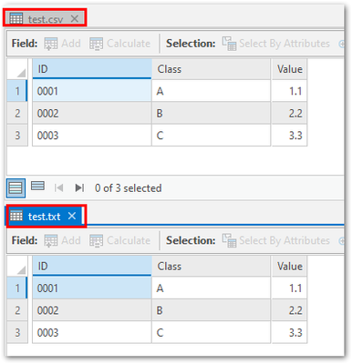

Create a schema.ini file in the same folder as the data, and explicitly define the data type for the attribute with leading zeros as Text.  You do not need to define the data type for all columns, just the columns you wish to change the type of:
Then reopen the data in Pro, you'll see the data typing is honored:
