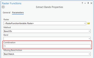

The easiest way I've found to export NDVI images (or any 'calculated' rasters) is to use the Extract Bands tool on your source raster first (found under the Raster Functions section, not the Geoprocessing section - this got me for a while), then combine the bands using the Raster Calculator in the Geoprocessing toolbox (confusing, right?!).
Process:
1. Export each band separately using the Extract Band tool, one-by-one using the Combination field:
(Don't enter more than one band in this box at a time, or ArcGIS will combine them in the extracted layer.)

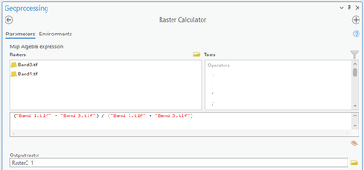

3. After you have extracted all of the bands you require, open the Raster Calculator in the Geoprocessing toolbox.
Enter the necessary calculations you require. My calculations were for NDWI, rather than NDVI, from a pre-processed image but that doesn't particularly matter here. Hit Run when you're done.
ArcGIS Pro will perform the necessary calculations, then store the result in the result in the project's default file geodatabase as a raster dataset. You can export the 'flattened' raster from there as a flat-file image if you require.
