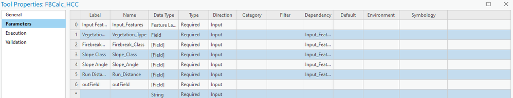

Thanks for your response. No I hadn't done this initially but now I have by navigating to the tool > properties > parameters > data type > then checking the multiple values box (see attached photo at the end), but still the same error message is produced. I did this only for the parameters where I would feed in multi-values.

RichardHowe
So inputs 2,3,4 and 5 are all setup to accept multiple values now? Because even if you know your listFields action on your script will only return a single field, you are still returning it as a list so the input to the next step will need to be for multiple values.
I think input 6 should not accept multiple values as you're only inputting 'buffer' so unless that is a list object rather than just a field name then that should just be a normal field input.

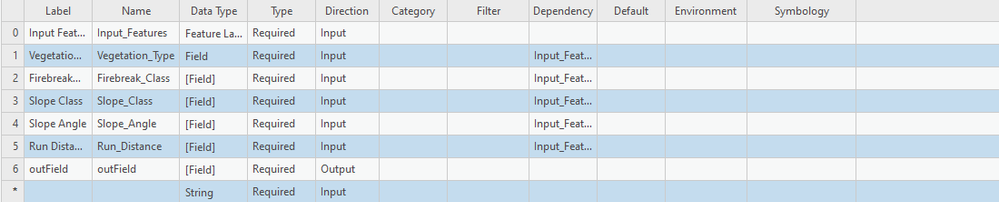

Sorry, there was a mistake in the tool params, here is the corrected version -
As you can see I want Input features and Vegetation_Type to be fixed. Everything else is inputted as a list and buffer/outField is the output (which should produce multiple fields). I changed this yet I continued to get the same error message -
RuntimeError                              Traceback (most recent call last)
In  [29]:
Line 1:     arcpy.FBCalc_firebreak('SusBui_Point_CopyFeatures', 'SusBui_Point_VEGCODE', Classfields , SlopeTfields, SlopeVfields, FRDfields, 'outfield')
File C:\Users\Kedaravindan Bhaskar\Documents\ArcGIS\Projects\FBM_research\FBTool\firebreak.tbx, in FBCalc:
Line 40:        return
Line 37:        """Modify the values and properties of parameters before internal
File C:\Users\Kedaravindan Bhaskar\AppData\Local\Programs\ArcGIS\Pro\Resources\ArcPy\arcpy\geoprocessing\_base.py, in <lambda>:
Line 520:   return lambda *args: val(*gp_fixargs(args, True))
RuntimeError: Object: Error in executing tool
Here is the code - (note that I also tried this code after changing buffer to a single field output in the tool parameters, but still, the same error message appears)
 Hope this can clarify my issue. Thank you so much.
