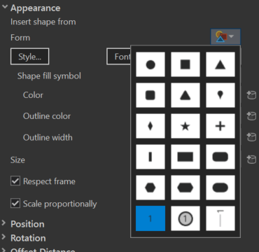

First, make sure you've enabled symbol property connections.
In the shape marker settings, you can choose a text template:
Click the database icon next to "text string" and choose your field.
You can also use that same connection for "color", though you may need to use an expression to translate the different values to hex codes.
Alternatively, you can use your code field for "unique values", and define each point marker the same way, and then just manually set the color for each.

It's absolutely possible. It takes a bit of tweaking, but you can have a font marker in your symbology and use an attribute to define what text goes in that marker. I'm not at my usual workstation right now, but I can add some screenshots to help explain this later.
