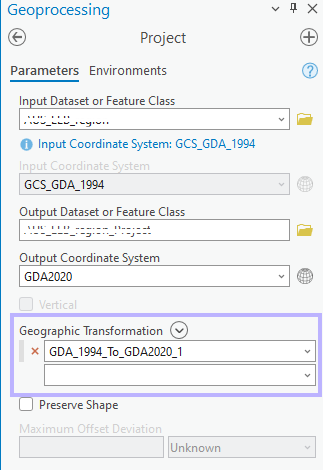

As one of those users, I often take data in WGS1984 or GDA1994 into project tool, accepting the default transformation(8048):

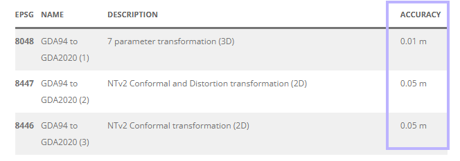

And I was yesterday-years-old when I learnt that there are much more accurate transformations, read the whole blog here

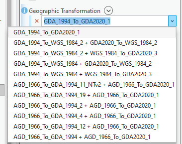

I suspect Pro 3.4 would have the newest transformation installed already, anyone know how to search by EPSG WKID? Looking for WKID 8447 & 8446.
I find Pro not so intuitive having a big drop down like this: I did a visual inspection as long as my patience took me.
