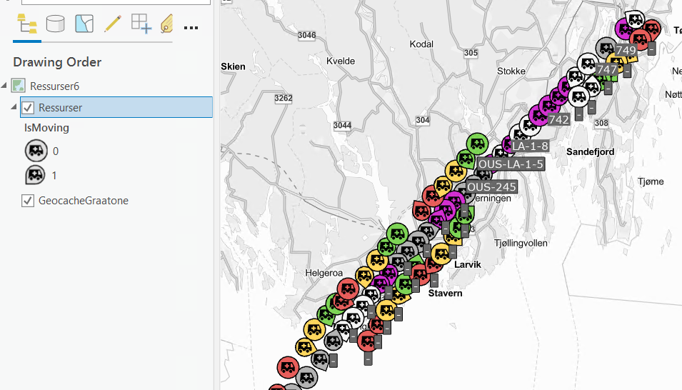

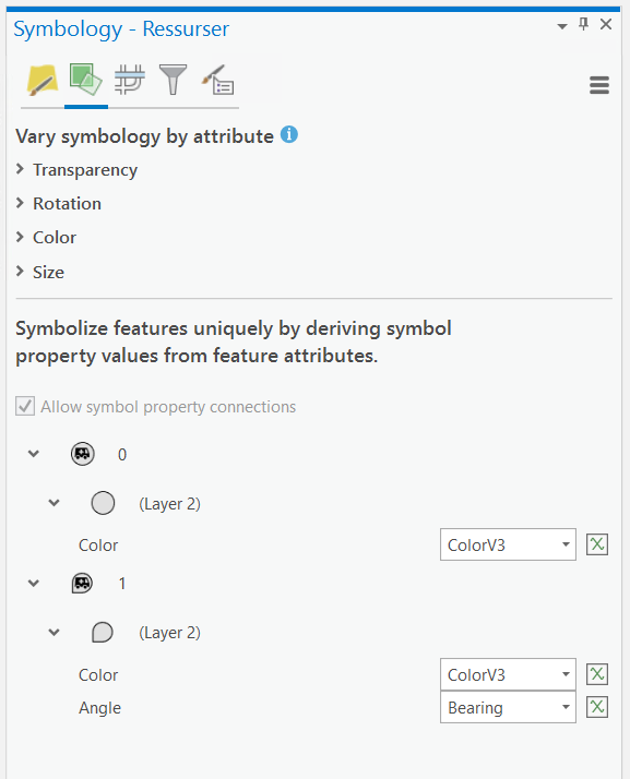

For some of our layers we have configured symbology in ArcGIS Pro. We use unique values and assign symbolgs which consists of shape markers imported from svg files. We vary colors based on different combination of attributes, so we have a simple Arcade expression assigned to proper markers. Additionaly, we rotate some of our symbols. Both dirrefent colors and rotation are configured under "Symbolize features uniquely by deriving symbol property values from feature attributtes". Some pictures for reference:

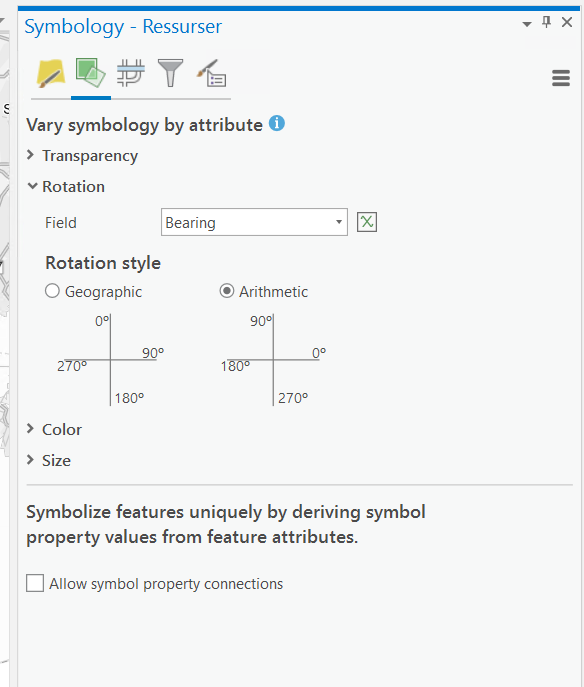

I made some tests and configured rotation in settings under "Vary symbology by attributte" instead of "Symbolize features uniquely by deriving symbol property values from feature attributtes". After publishing, the configuration for rotation is available in json code. I attach json code as reference also for this service.
So my question is: Is the symbology configuration under settings "Symbolize features uniquely by deriving symbol property values from feature attributtes" supported on web-level?
If yes, do you have any idea why it is not visible in my json code for service after publishing from ArcGIS Pro to Portal for ArcGIS?

Symbology configuration under settings "Symbolize features uniquely by deriving symbol property values from feature attributes" is currently not supported in ArcGIS Runtime SDKs or on ArcGIS Online Map Viewer. It is on the road map but has not been prioritized for a near future release and hence has no definitive time lines yet.
I would appreciate if you could provide some more details about your current workflow and how and why do you need this feature? Do you need to simply consume a webmap published with this configuration in Runtime SDK or do you want to configure these properties on the renderer using API. This will help us evaluate and re-prioritize the issue. Thanks
