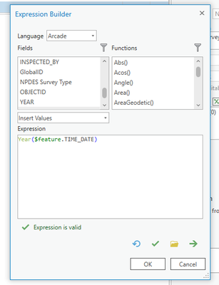

I am trying to sort out what I am doing wrong with my attribute rule. This is my first time dabbling with it.
I have two fields. One is a date and time field. This is filled by a survey. The Year field is where I want to apply an attribute field. I want it to only have the four digit year from the date and time field.  However, the year that is returning is 1899.
I have tried a few variations in the expression but none are working.
Thank you for your kind help to solve this.

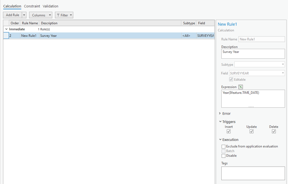

If you just run a field calculation, does it work? Or are you manually triggering the rule some other way? I notice your rule is only set to fire on feature edits.
- Josh Carlson

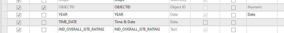

Your YEAR field is a date field, but the Year function in Arcade returns a numeric value. In order to call something like Year(Now()) and get 2022 stored in your field, it needs to be a different type.
Since Date fields are really just integers representing "milliseconds since <your DB's reference timestamp>", you'll probably end up with a bunch of values just a few seconds after midnight on that reference timestamp, the way your field is set up now.

So say for my date and time (field name TIME_DATE) field which is formatted as in the photo below.
JessicaJThompson_0-1644502129949.png how would I write the Arcade expression to pull just the year out, and have the column formatted as just the year and not an entire date.
Thank you for your help!

If you have a field "TIME_DATE" and you want to populate another column "YEAR" with the year, it would just be as simple as
Year($feature.TIME_DATE)
just like you have written in your original post.

MVP Alum

Hello @jcarlson
It worked when I did a field calculate - so I added a new survey record and IT WORKED!!
Thank you thank you!
