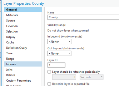

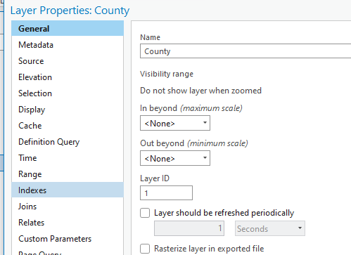

When I add that layer to my map it comes in as a single item in a group. Even though I've pulled it out of the group, could this be the issue? Is it seen as a feature collection?
I have checked the UniqueID box in the map properties, maybe I have the wrong ID?
