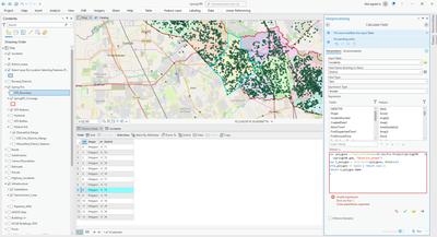

MarkLeander1
I'm missing something here (but I've ordered an Arcade book).
I have a polygon layer containing 8 polygons and a points layer containing 67,000 locations. I'd like to create a field that uses an approach like this to assigns each point to a polygon based on its location - so that the field being calculated gets the appropriate polygon name.
When I use the above expression every data point gets the same polygon name regardless of its location.
Thanks for any help you can offer - I'm new to using Arcade.
Mark
MarkLeander1
Clearly - I'm not getting something... can you help?
