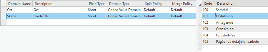

I'm trying to create an attribute rule that changes a domain value when a specific date is passed.
So the main problem I'm trying to solve is this:
When a feature is created, the feature gets domain code 105. When the feature is up for review in a process, the administrator changes the domain code from 105 to a value between 100-104 and sets a end date in another field. When the end date is passed I want the domain code to change back to 105.PetronellaHauptmann1_0-1648024129484.png
