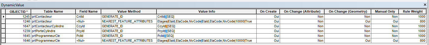

In the old Desktop Attribute Assistant, you could create multiple rules:
  1. Create a rule to generate incremental sequential IDs (Max + 1) based on the last generated ID (the generated ID starts at 1000).
  2. Copies a series of values from the nearest feature in a specified layer.
In the screenshot, you can see how the rules are defined in ArcMap/Attribute Assistant. I've tried several codes in Attribute Rule without success. How can I achieve these actions in ArcGIS Pro?"
