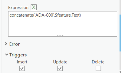

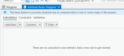

Hi @Anonymous User ,
In ArcGIS Pro, click on the feature class layer you want to add attribute rules to in TOC and then click Data tab > Attribute Rules in Design.
In Attribute Roles windows you can add a Calculation Rule in Arcade like:
concatenate('ADA-000',$feature.<your fc field>)
I hope that helps.
Cheers
Mehdi
