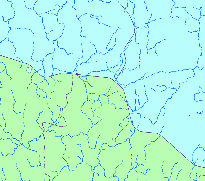

I am working with a large set of Ontario watercourses and wish to automatically populate a field with the nearest road network. In the picture below, the watercourses are represented by the blue lines and the road network is represented by the purple lines.
I am trying to have a field titled NearestRoad auto-populate with the nearest road network that is 100km from it. Is there a way to go about this? Thank you!

function closest_feature(test_feature, compare_feature_set) {
  var min_distance = 9999999
  var closest_feature = null
  for(var f in compare_feature_set) {
    var d = Distance(test_feature, f)
    if(d < min_distance) {
      min_distance = d
      closest_feature = f
  return closest_feature
var roads = FeatureSetByName($datastore, "RoadFeatureclass", ["RoadID"], true)
var waterway_buffer = Buffer($feature, 100, "kilometers")
var close_roads = Intersects(roads, waterway_buffer)
var closest_road = closest_feature($feature, close_roads)
if(closest_road != null) {
  return closest_road.RoadID
return null
Have a great day!
Johannes

Do you want each tributary of a watercourse tested separately or if any tributary is within 100 km of a road?
That will make a big difference on the outcome.  For example, how many different ones are depicted in your image?
