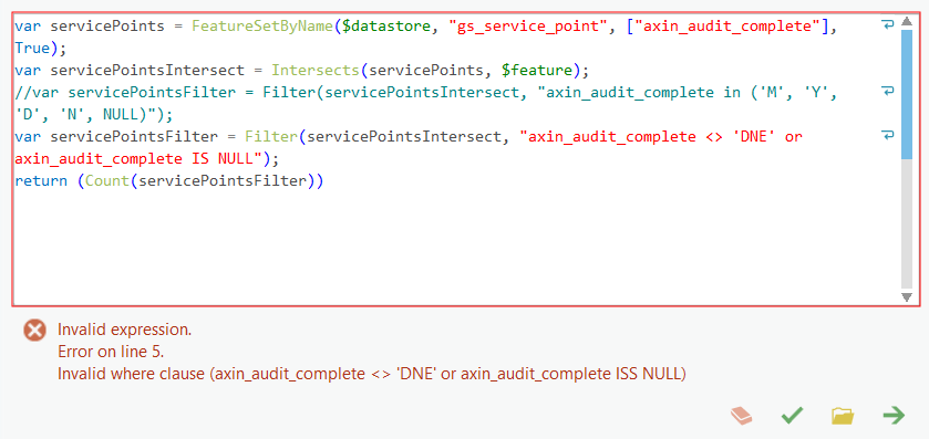

After Further investigation it seems that the null values are the issue. The query "audit_complete <> 'DNE'" does not pick up null values? Dont know why but null is not DNE so those null records should be picked up.
So I have tried to update my Filter query as follows:
var servicePointsFilter = Filter(servicePointsIntersect, "audit_complete <> 'DNE' OR audit_complete IS NULL");
However this causes a further issue where the arcade parser somehow interprets the "IS" statement as "ISS" ??? See the error message below
Not sure why is interprets the "IS" as "ISS"
cheers
Callum

I'm going to tag Kory Kramer‌ to see if he knows about an issue related to using IS in a filter in Arcade in Pro.
KoryKramer
Esri Community Moderator
There isn't anything I could find regarding IS being interpreted as ISS but I'm curious about the OR.
Logical or in Arcade is ||
https://developers.arcgis.com/arcade/guide/logic/#if-statements
Does that help?
XanderBakker
Esri Esteemed Contributor
Hi Kory, thanks for sharing, but we are not refering to the or in Arcade (javascript) but inside the string which is a SQL expression that the Filter function in Arcade uses. Have you tried that?
KoryKramer
Hmm, OK.  I just set this up and it validates and seems to return the correct value:
I'm in a daily build of Pro 2.4 so have not looked at this in an earlier version.  It might be worth working with Tech Support if deep troubleshooting is required!
XanderBakker
Thanks for testing Kory. At least it is good to know that it is working correctly in 2.4
