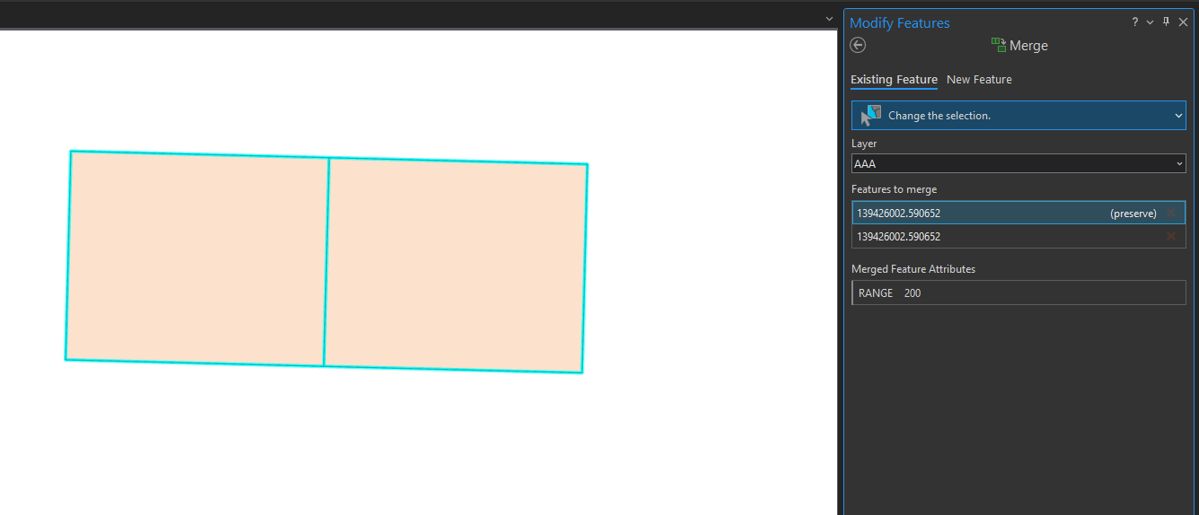

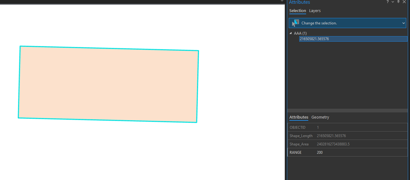

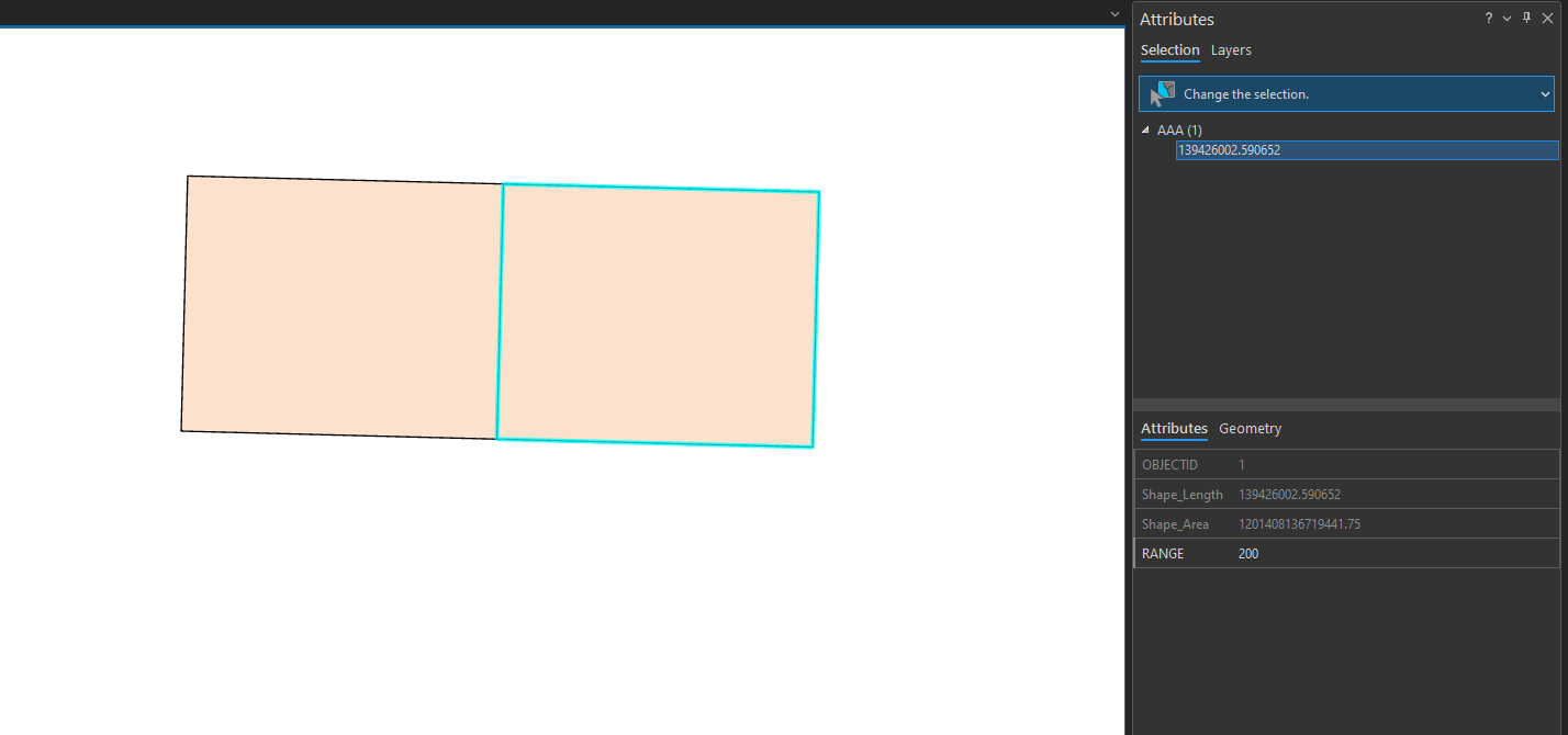

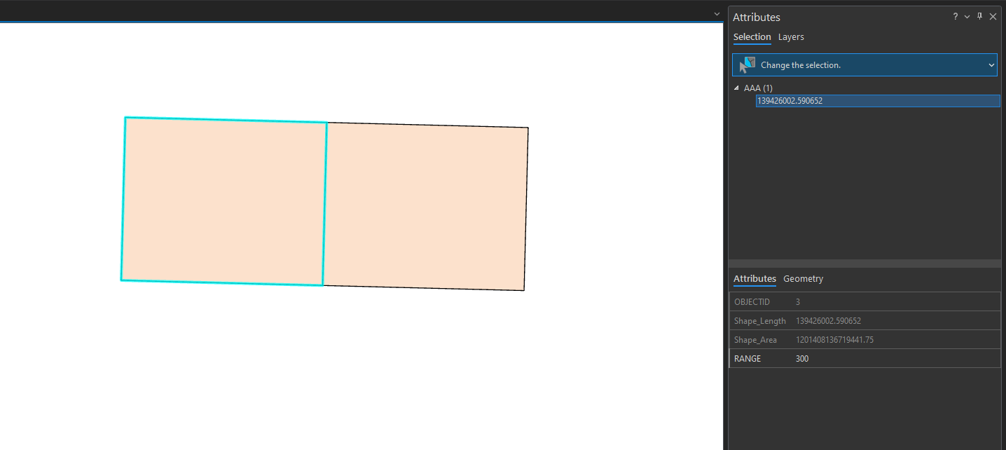

Hi
I have a problem. I created a range domain and defined the <Sum Values or Area Weighted>in the merge policy. After that, when I merge two features, the result is not the sum of the two features. It takes one of the values from the source features.
MohamedIsmael_1-1736667299743.pngMohamedIsmael_2-1736667309095.pngMohamedIsmael_3-1736667343600.pngMohamedIsmael_4-1736667359044.png

The simple answer about your question is that there is no tool in ArcGIS Pro that honors merge policies at the moment. The use case(s) highlighted on this thread are solid and there are others relevant to Utility Network users that the development team is actively monitoring as guide to prioritization and eventual implementation.

@MohamedIsmael , @DuncanHornby Domain merge policy is not currently supported for the Merge editing tool(also documented here). However, the expectation you have documented is reasonable. I also wanted to mention that this is on our radar for consideration. Thanks.
You are welcome to enter this as an idea for others to upvote.
