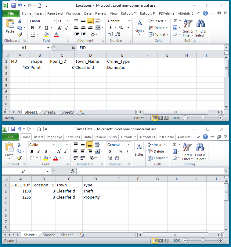

Within ARCGIS Pro I have a layer (Locations) and a standalone table (Crime Data).
The Locations feature has an x,y coordinate while the standalone table does not. The rows in the Crime_Data table share the exact Town_Name and location as in the Locations layer but without an x,y coordinate pair.
Is there a way to add/append the two rows from the Crime_Data table up into the Locations layer so that layer would grow to include all three rows, x,y coordinates, location name and crime type?
That way if I wanted to see all locations with Thefts I'd get back Clearfield and if I wanted to see all locations with Property crime I'd get back Clearfield.  I have really simplified my data/table example but I  would have many locations in reality.

attribute join... a many to one, however, I would keep the attributes separate and join when needed since having a whole load of records associated with a point isn't going to useful on a daily basis

I just looked into your approach. You’re correct but does that hold true in that I’m trying to join many Crime-Data location rows WITHOUT point geometry to one Location WITH a point geometry?  I only see a one to many and not many to one option.
Does that seem right?

one point to many records  (relate) Add Relate (Data Management)—ArcGIS Pro | Documentation
