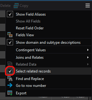

Build relationship classes or relates between the owner table and the property feature classes.
In the owner table, check this option:
Now when you select an owner, all their properties will be selected.

JohannesLindner
MVP Alum
Have a great day!
Johannes

When I tried that it gave me the option of selecting only the point and only the lines, etc.

That's weird...

When I enable that option in the table (Gewässer) and select a river there, ArcGIS automatically selects everything linked to that river.
Are you sure you checked the option "Select related records"? It sounds like you tried the "Related Data" menu above it, which indeed lets you only choose one related feature class.

I am sure you are right. Thank you!
