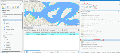

Hi. I am trying to easily create a polygon of a lake (Beaver Lake in Arkansas). I was unable to find a shapefile of strictly the water online. Can anyone suggest the easiest way to create a simple polygon of the entire lake (anything but tracing the whole shoreline)?

I could extract it from ArcGIS Living Atlas (National Hydrography Dataset Plus Version 2.1)
Spatial Reference: GCS NAD 1983
Used Copy Features tool to copy the selected feature to a shapefile.
