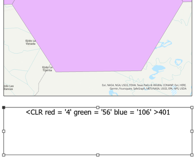

Hello All,
I have an Arcade expression that conditionally colors a piece of text in a layout.  If I remove the CLR bits it works but with a default color of black. I'd like to get it working with the color assignment if possible. Here is the current statement that proves out as working but I don't get the color I just get the actual color statement characters.
I'd appreciate any coding help.

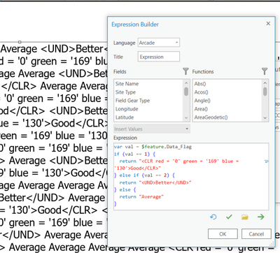

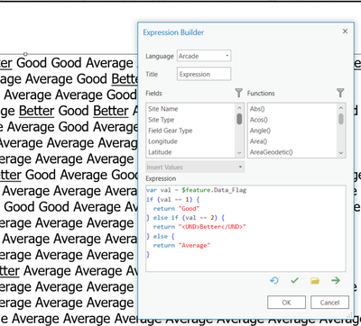

I just tested this with a Dynamic Text element (a table) and I get some interesting results. First I used your expression and it worked.
I then changed the second evaluation to another formatting tag and it worked.
But when I added the two tags together, it broke

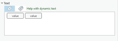

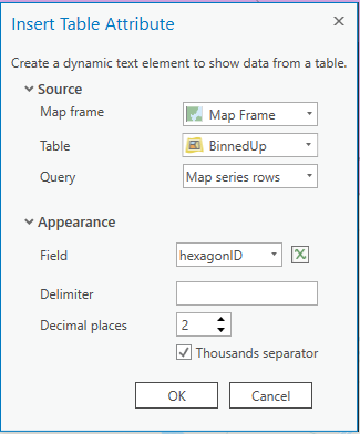

1. Create a dynamic text element and select Table Attribute for the source. In the Arcade select the field you want dispayed.

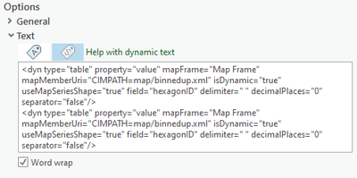

2. Click on the view source tag above the dynamic text box tag area. Copy the source code and paste a second copy of it above.
You should now have 2 tags when you switch back to tag view.
3. Click on the first-most tag (the one we pasted in the front, really it just needs to be the first tag not the second).

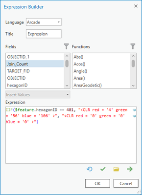

4. Edit the Arcade to be something similar to this...
IIF($feature.hexagonID == 401, "<CLR red = '4' green = '56' blue = '106' >", "<CLR red = '0' green = '0' blue = '0' >")
*Note mind the spaces. Formating has to be exact in the CLR tags.

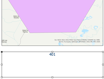

Click OK and you should see this.
5. Add the close tag for the CLR. </CLR> goes directly in the tag section at the end.
You should now see this in your map series or layout.

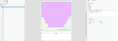

and here is a screenshot of the entire project...

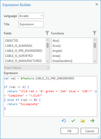

Thanks to your post, I was able to figure out a way to set up the code so I didn't have to duplicate a tag and then manually add a </CLR> at the end since I figured if I wrapped it all into a variable it would work. The new code is as follows:
var datafield = $feature.CABLE_IS_COMM_AND_ACCEPT;
var comcolor = "<CLR red='84' green='109' blue='63'>" + "Complete" + "</CLR>"
var inccolor = "<CLR red='255' green='121' blue='0'>" + "Incomplete" + "</CLR>"
Iif(datafield == 1, comcolor, inccolor)
This code worked in a test dynamic element but when I applied it to our existing ones, it broke again. However, you had made mention of don't double click bounding boxes but that got me thinking if the bounding box itself was the issue. Our bounding boxes for the dynamic text elements had been 1.2 inches wide with text centered since that made everything line up correctly on our layout. What I did instead was to make them all 6 inches long and shift the X position to offset by 2.4 inches to account for the wider box.
This has now allowed the expression to stick while changing pages in the map series and while exporting the series to PDF - all of which had broken before with your workaround of manually adding </CLR> at the end. Additionally, double clicking the bounding box does not break the expression - the full tag text appears when you double click but once you click off the display returns to normal.
