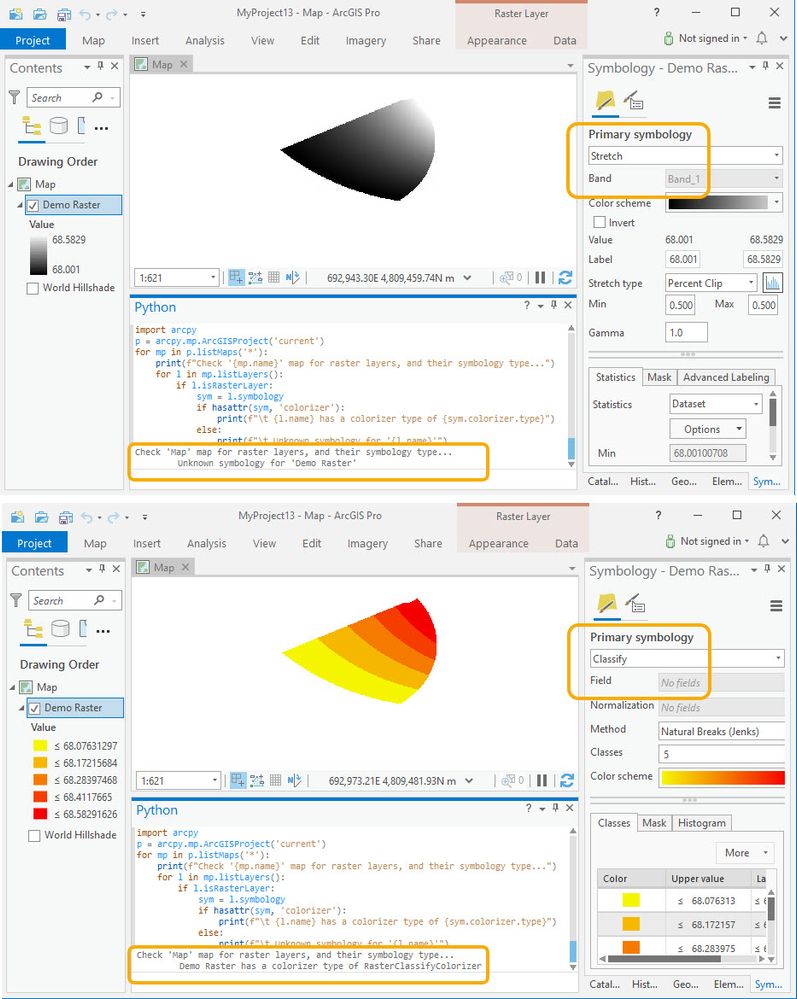

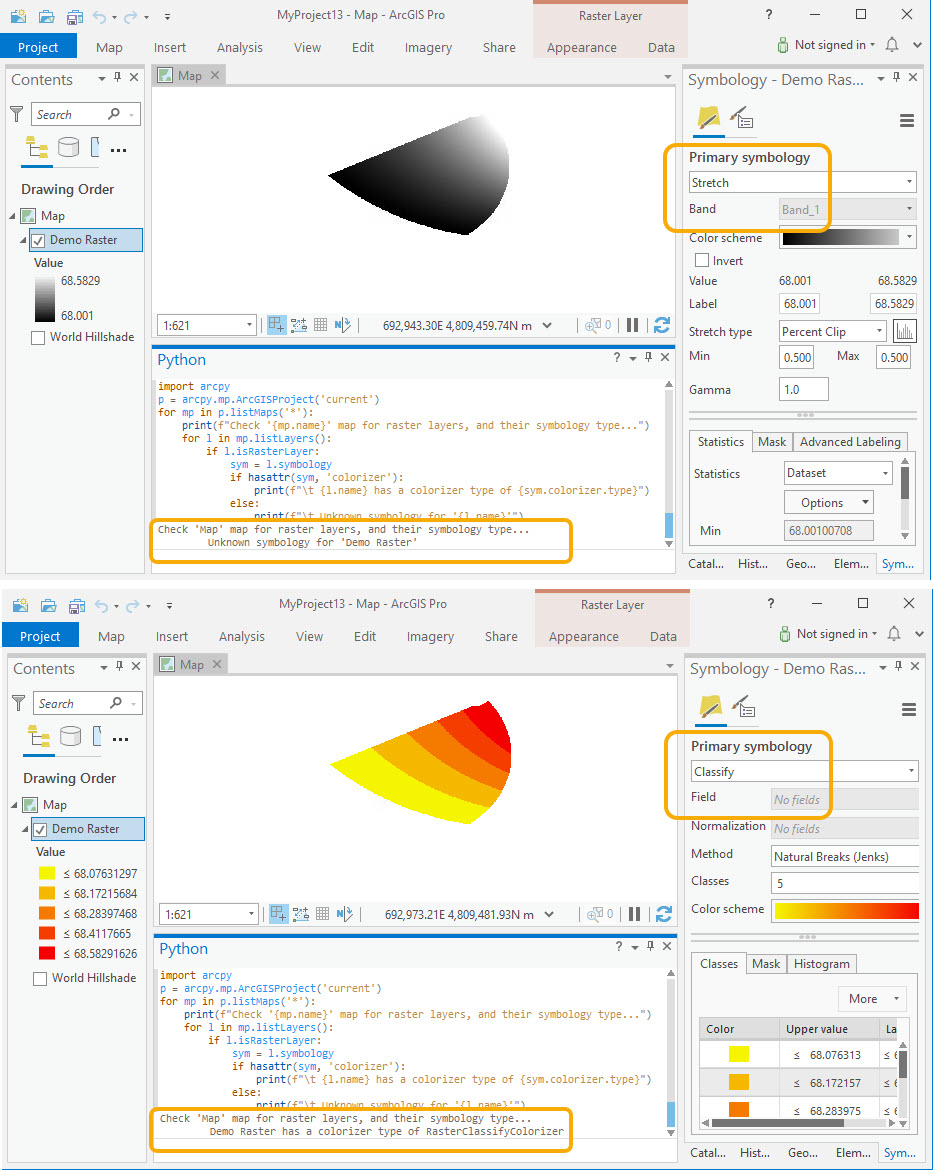

ArcPy is not detecting a raster layer's "colorizer" type when the layer is set to "Stretch" symbology. The ESRI documentation suggests this should be possible. Am I missing something?
Here is the Python snippet shown in the screenshot:
import arcpy
p = arcpy.mp.ArcGISProject('current')
for mp in p.listMaps('*'):
  print(f"Check '{mp.name}' map for raster layers, and their symbology")
  for l in mp.listLayers():
     if l.isRasterLayer:
         sym = l.symbology
         if hasattr(sym, 'colorizer'):
             print(f"\t {l.name} has a colorizer type of {sym.colorizer.type}")
         else:
             print(f"\t Unknown symbology for '{l.name}'")
