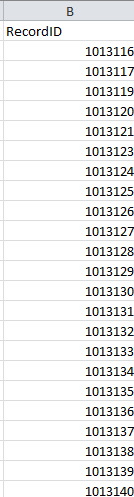

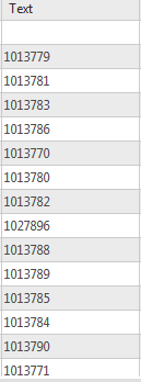

I think the issue might also be arcpy.CopyRows_management, because in standalone Python, four rows are copied from the csv to the featureClass with no issues. Run in the toolbox in Pro, all of these fields are there but the values are null. Only two of the four fields are actually calculated in the code snippet above. I looked at the formatting, and the "Text" field from the featureClass is indeed a text field. The RecordID field in the csv is general format. I tried saving it as a text field, but the issue persists. It doesn't work in Pro with the field named either "Text" or "TextString" but it works in IDLE.
featureClass:                         CSV:

left justified is usually text, right justified is usually numbers.  I would do the join after you make the csv a gdb table to confirm whether the csv column is being treated as text or numbers.  If it is being treated as numbers, then you will need to convert the column to a new text column
