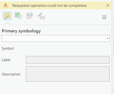

When I try to import symbology via the Python command window, it appears to work, but instead, the symbology has NOT changed, and I get this message below within the Symbology pane. I actually have to remove the layer from the map entirely, and re-add it to the map in order to update the symbology at all.

I'm experiencing the same exact issue. I'm using Arcgis Pro 2.2.4.
Using the Apply Symbology from Layer tool through the UI works fine. Through the Python window, however, no luck. After running the tool using the UI, I copied the code snippet from the geoprocessing history window. Running that code results in the behavior described above.
ToddHorner
To add to my above comment. When I run the tool from the UI, my window looks like this:
This works fine. When I copy the code snippet from the geoprocessing history, the code looks like this:
Executing this code results in the behavior described above by Daniel Matranga.
