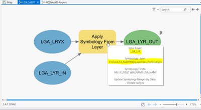

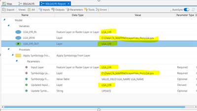

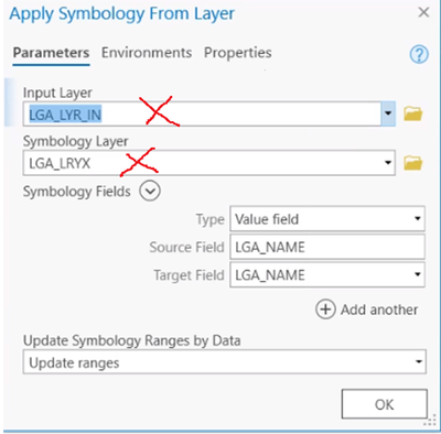

LeandraGordon
I tried using ApplySymbologyFromLayer in model builder and can confirm it doesn't work in Pro 2.7 as a standalone model on existing layers.
The model seems to get confused on what is a Variable Name and what is a Variable Value:
1. Looks ok:
2. Looks ok
3. The Variable Name is now the Variable Value:
It doesn't work in a Python Toolbox either -> https://my.esri.com/#/support/bugs/BUG-000136115
