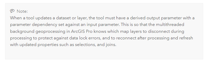

I thought I had cracked the problem when I came across the following, but when I added the second derived parameter, it made no difference.
