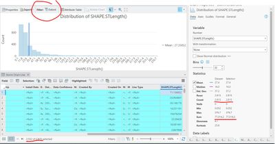

All I'm trying to do is get a total value for the Shape.STLength() field for a feature class. I've selected the records I care about, but when I right click on the field and choose statistics, I get the statistics for all records. The attribute table is only showing selected records, and the only filter option is by extent.
What am I missing here?  This should be very simple (and it is in ArcMap, which I am seriously wishing I could just use forever).
Screenshot attached. 

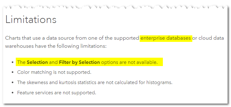

There is this thread from 2022 that discusses this issue and within the "solution" it is stated that apparently it's part of a "performance enhancement" introduced in 3.0. The documentation referenced in the linked thread is here.
alex_friant
Wow, you're right. There it is right there.
They should add a tool tip when you hover over those options that state this so users aren't thinking it's buggy behavior.
