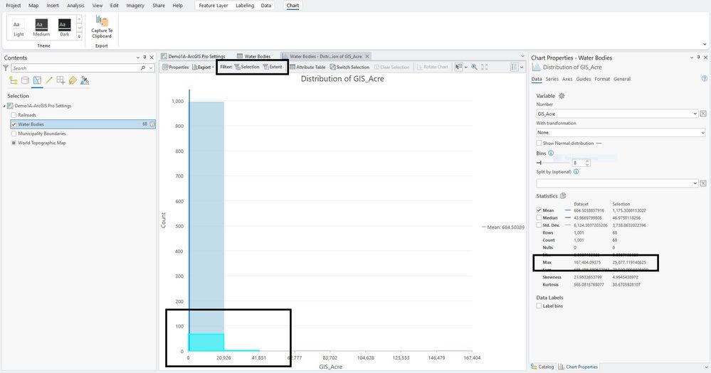

Christopher - what ArcGIS Pro release are you using?  I'm using ArcGIS Pro 3.x and have the Selection Filter on my distribution statistics as seen below.  It does honor selections and shows the dataset statistics as well.

@sbednar - apologies for the tardy response.  So I'm using a fGDB polygon feature class, added a field called GIS_Acre, calculated US Acres, selected 68 polygons, opened the attribute table, right-clicked the GIS_Acre field and selected Visualize Statistics.  This creates a chart and opens the Chart Properties pane.  My selection filter is not grayed out. I can click the Selection filter on/off and see the results in the chart and the statistics in the Chart Properties pane and the MAX value for the selection.  I verified that the MAX selection value is correct by sort descending in the attribute table for the GIS_Acre field.  I'm using ArcGIS Pro 3.4.3.  See image below:
