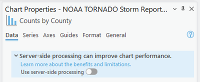

Hi all, I'm closing this because we have not been able to reproduce the original bug where the selection statistics are displaying the same values as the entire dataset.
I also wanted to mention that starting in Pro 3.2, server-side processing is turned off by default, so chart selection and selection statistics should be available automatically when the data comes from a cloud data warehouse or enterprise database. We also introduced a toggle in the Chart Properties pane to facilitate turning this setting on/off:
Thanks,
Chris
