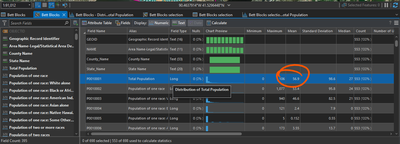

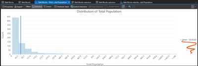

When making a selection with a chart open, a column called 'Selection' appears in Chart Properties. I would think that it would display statistics for your selected features whereas the 'Dataset' column would show stats for the entire dataset. However, with a selection, the 'Selection' column seems to show the same thing as the 'Dataset' column. It would make more sense if the 'Selection' column actually reflected your selection.
In the below example, I select 553 features. The selection column appears and populates statistics for 698 features, which is the entire dataset.

Also, what you're saying about data source isn't totally true, as selection-based statistics are available within Data Engineering.
It gets really confusing when opening these charts outside of the DE view - again, the charts within the DE table show statistics based on the selection, but when popping the chart out, they revert to the whole layer with no indication that this is the case. For an area of the application aimed at empowering users to ensure data integrity, this is really alarming. There should at least be some kind of warning that despite making a selection and seeing the selection reflected in DE, clicking the 'Selection' filter in the chart, and having a 'Selection' column, you are not working with your selection once you leave DE.

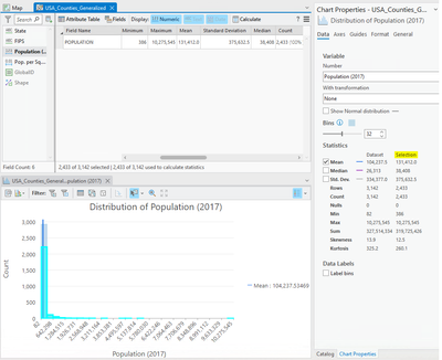

Thanks for the feedback. The "Selection" column in the histogram statistics panel should calculate and display statistics for the selected features, but unfortunately it appears that this is not the case in your examples. As @AmeliaBradshaw mentioned, the exception would be if the data comes from an enterprise database or cloud data warehouse source, but selection should still work as expected with a feature service.
I tried using steps that are similar to your video (with a layer from Living Atlas) and could not reproduce the issue. The selection statistics for the histogram appear to match what is displayed in Data Engineering:

I checked on Pro 3.0.2 and am seeing the statistics section populated in the Chart Properties pane for histograms:
I tried with a variety of data sources (shapefile, file geodatabase, enterprise geodatabase, CSV) and the statistics were displaying in all cases.
