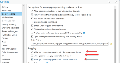

More information on the "geoprocessing options" metioned by @DanPatterson can be found here in the "Logging" section:
https://pro.arcgis.com/en/pro-app/2.9/help/analysis/geoprocessing/basics/geoprocessing-options.htm
