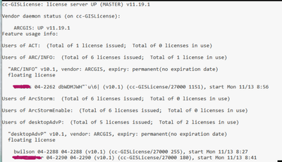

You can also see who is using licenses via command line. In a powershell I do this
cd c:\Program Files\ArcGIS\LicenseManager\bin
.\lmutil lmstat -a -c service.txt
and I get output similar to this. Note "ARC/INFO" is really Desktop and "desktopAdvP" is Pro.
