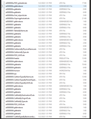

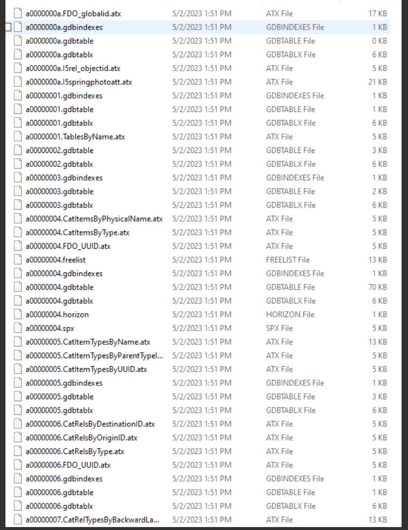

I have a series of photo attachments for a series of locations in the form of STX, GDBINDEX, GDBTABLE, FREELIST, HORIZON, and SPX files (54 total; screengrab below of most of them). However, I can't get ArcGIS to read the files, or even recognize them; the folder they're in keeps showing up as blank in the catalog pane, and when I try to drag them in it tells me it's an unsupported data type, without any further explanation. I'd appreciate any insight, thanks.

I may be missing the mark here, but it looks like you are showing what's inside a file geodatabase folder. Have you tried putting your photos outside of the geodatabase? What kind of message are you seeing (or not seeing) to indicate that Pro can't see your attachments?

What you are showing is a File Geodatabase. I assume the folder you have has the file extension of .gdb. You need to open ArcGIS Pro, go to Add Data and navigate to the folder containing the Geodatabase. In there, you should see the feature classes that hopefully contain photo attachments.

I'd been trying that, but the folder keeps showing up as empty in ArcGIS Pro when I navigate to it in the catalog pane, even though the files show up in the file explorer outside of ESRI, as shown in the screenshot above.

Dumb question, but what is the name of the folder they're in?
Pro won't recognize a file geodatabase unless the folder ends with ".gdb"
That may be your issue.
