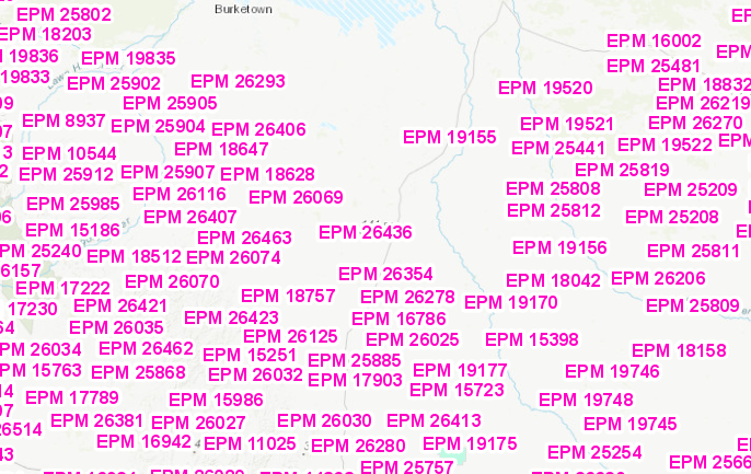

Hello, I am having an interesting issue with ArcGIS Pro not displaying the polygon boundaries of a WMS layer but displays the labels.
If I load the following layer Layer: EPM Granted (ID: 3)  into ArcGIS Pro then only labels are displayed.

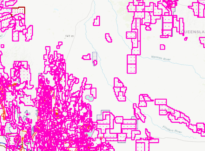

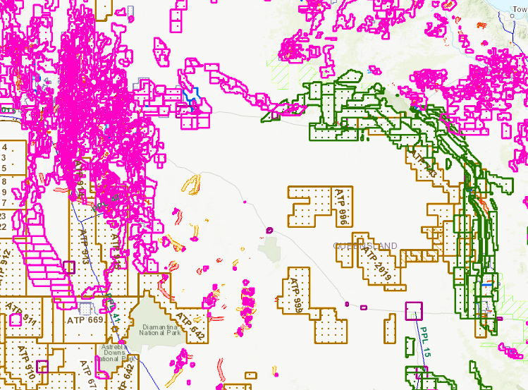

IF I load the full WMS Economy/MinesPermitsCurrent (MapServer)  then it shows all the layers and

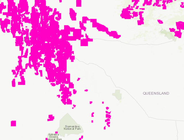

If I do the same in Portal for ArcGIS I get all layers showing
