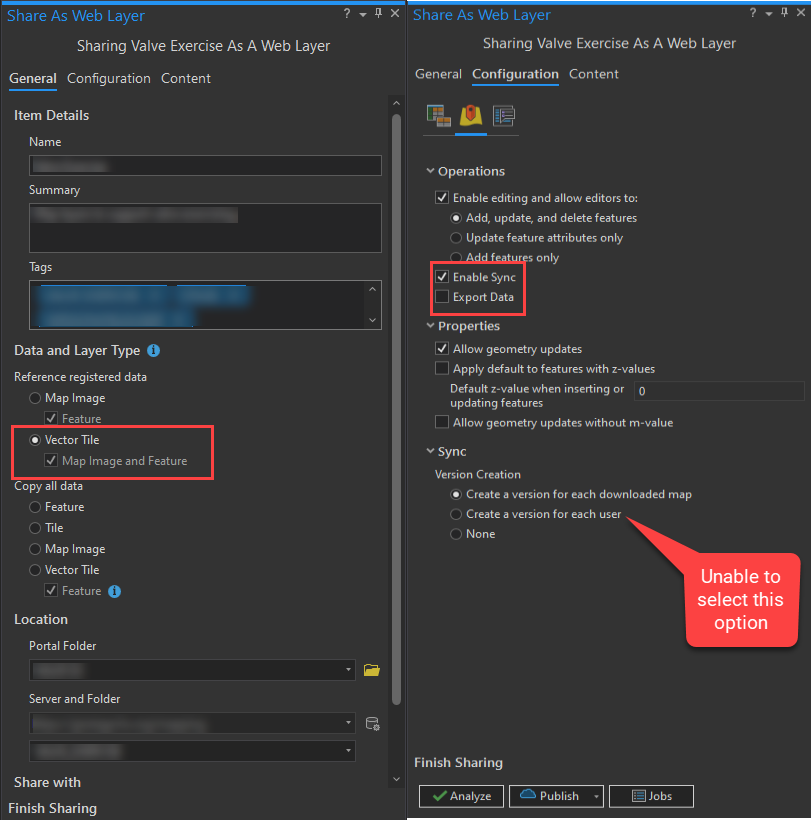

ahargreaves_FW
@JonahLay  I'm using Pro v2.9.2 and a 10.9.1 portal but despite configuring my Feature Service to have Sync Enabled I am unable to select 'Create a version for each user' when attempting to publish my data as a vector tile referencing registered data (as shown below)
JonahLay
@ahargreaves_FW Thanks for reporting this. This does look like a bug that should be fixed in a future release.
ahargreaves_FW
@JonahLay is there a BUG number to track this? Or do you need me to open a support case to report this bug?
JonahLay
@ahargreaves_FW Our teams are aware of this issue. But if you would like to track progress, yes, feel free to open a support case.
