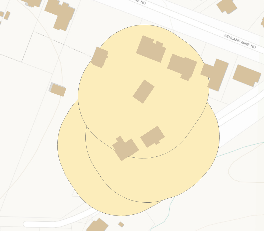

I am trying to find out the average value of a nearby polygons using the Summarize within tool.
The problem I am running into is that the average is not what I expect it to be if I average it manually.
From the tool reference page Summarize Within—Help | Documentation
in_polygons
The polygons used to summarize the features, or portions of features, in the input summary layer.
I think that it is using Portions of features within the 40 ft buffer I am using. I cannot find any documentation on when it uses a portion or all. I have tried getting the average of a polygon that has all of 4 buildings in it and it does not even get the average right when I would think that all the polygon would be used. At this point I don't know how it calculates "mean".
The page defines: Mean—Calculates the average of all the points in each polygon.
Any suggestions?

draw the polygon with no fill. I am wondering if the top polygon clips the building closest to its perimeter in the north end, which would leave you with one polygon that contains 2 buildings.

Here are the 4 values of the buildings that touch the polygon.
35.33333
46.5
44.83333
38.66667
Here is the mean that the output results.
43.646452

Ok that makes sense now, if they do indeed intersect the portion of the building that intersects with the circle.  The simple addition average you show would only be for buildings *completely within* the circle.

The mean is an area-weighted mean of those four buildings. The building that has the most overlap will contribute more towards the mean.
Based on your pictured values and the output mean value it is very hard to tell if the value is correct, there just isnt enough information. We need to know the area of overlap between the highlighted circle and each building that intersects it, then we weight those buildings values by how much of the total overlap they contribute. If you want me to double check the match and send you the results, send a sample dataset to [email protected]
The mean WILL NOT be the average of (35.33333+46.5+44.83333+38.66667)/4. Doing an average like this throws away the spatial component of the analysis, since each of those buildings spatially overlaps the highlighted circle different.
If you want a simplified result that does the basic average I just described, Spatial Join can accomplish it using a MEAN Merge Rule. Spatial Join—Help | Documentation
