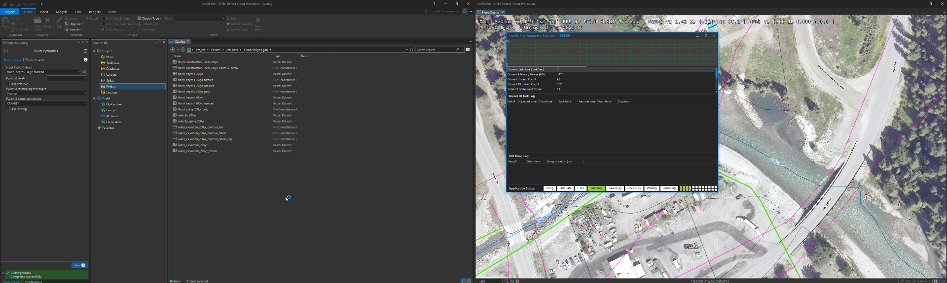

Can't really figure out why ArCGIS Pro is crushingly slow. The monitor isn't showing much action yet Task Manager is reading 100% usage from Pro. It was working fine yesterday and before and I haven't introduced any variables between now and then. I have googled and found the blog about performance with ArcGIS Pro. Restarted, tweaked the display settings in the Options menu. Still super slow waiting minutes for the UI to start responding.

For example, I'm literally rearranging one legend item order with drawing paused and it locks up for 30 seconds. Or I will simply collapse a single layer to hide the symbology in the content pane and it locks up for 30 seconds, 100% CPU usage to collapse a layer!
