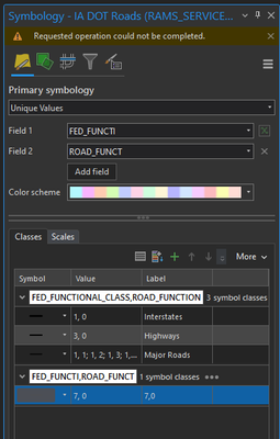

I'm running into this today with Pro 3.0. It's just a plain old shapefile, symbolized by two fields. I'm able to edit the symbol for the first three that I added some time ago, but unable to change the symbology of a value I added recently. I've tried closing/reopening, copying to a different map, etc. Sometimes it will let me click in and "edit" the symbol, but it does not update on the map and is reverted when I reopen the pane.
wayfaringrob
Honored Contributor
Alright - I think I found a solution for at least my case - that first heading that shows the longer field names? That came from the AGO version of the layer from which I imported symbology. The names are truncated in the .shp, obviously, and even though the symbology was referencing the truncated fields, the label of that heading was still showing up with the full names, and this was causing issues. I was unable to move or remove the "7, 0" class, but I could remove the heading and classes from the 3 dots. I then renamed the header with full names to the truncated names and re-added the value. It joined the first header and I am now able to modify the symbology, move it, remove it, etc.
GIS-Chops
Thanks @wayfaringrob this fixed my issue. I'm going to post video about it and give you a shoutout. Thanks for being a contributor.
I had deleted the heading on categories I already had in the layer, went to add a new value and couldn't group the new value with an existing value until I put the heading back in the existing symbol classes.

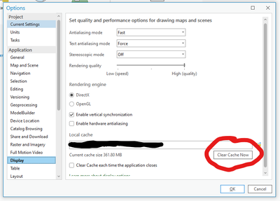

I was experiencing the same issue - ArcGIS Pro 3.0.1. However, after much fussing and cussing, I cleared my graphics cache and the problem cleared up. Not sure this is the answer but I thought it might help someone else.
