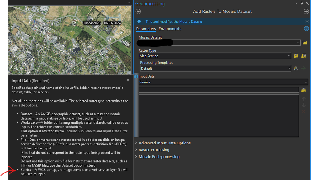

1) You can load a service into a mosaic dataset (MD) and then generate A and likely B [personally haven't tried this but I don't see why not]. One way you can try is creating a MD, loading the cached service you have of the imagery into it, and then you can generate A or B. This isn't a loophole to then use the raster calculator on the service - since your data is still compressed being cached.
2) I'm going to go with yes, WCS is supported. I looked at one of my image services in ArcGIS Server Manager and from there, you can configure it to use WCS. With that being said, I'd image Pro would be able to view it. Not sure about the analysis part.
