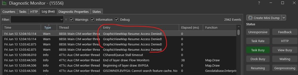

I keep running into an issue when inputting and enterprise geodatabase file location as an output for a gp tool. I opened the diagnostic monitor and am see thing...? what does this indicate??
imansbburg
I'll add, it really takes a painfully long time. Another error i'm seeing in the diagnostic monitor's log tab is:
<Event time="Fri Jun 13 12:04:10.114" type="Warn" thread="8858: Main CIM worker thread" elapsed="0" function="" code="">
GraphicViewMap Resume: Access Denied!
</Event>
What is this error about access view denied for graphic view map? all my poor performance issues appear to be related to referencing our enterprise geodatabase.
