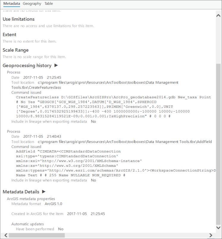

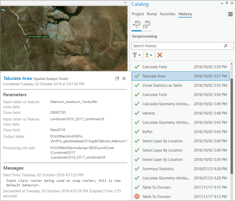

Perhaps it would be a good idea to check your geoprocessing history to see
whether the edits were logged, and if so, to the same feature class you
expected?
Edits are also recorded in the file metadata. You may want to check these
in Catalog view.

Hi Dan
No. I was actually thinking in terms of the geoprocessing history as recorded in the Catalog pane history tab. See my screen-grab. All processing recorded here.
And as an example of the geoprocessing  history recorded in the metadata.
