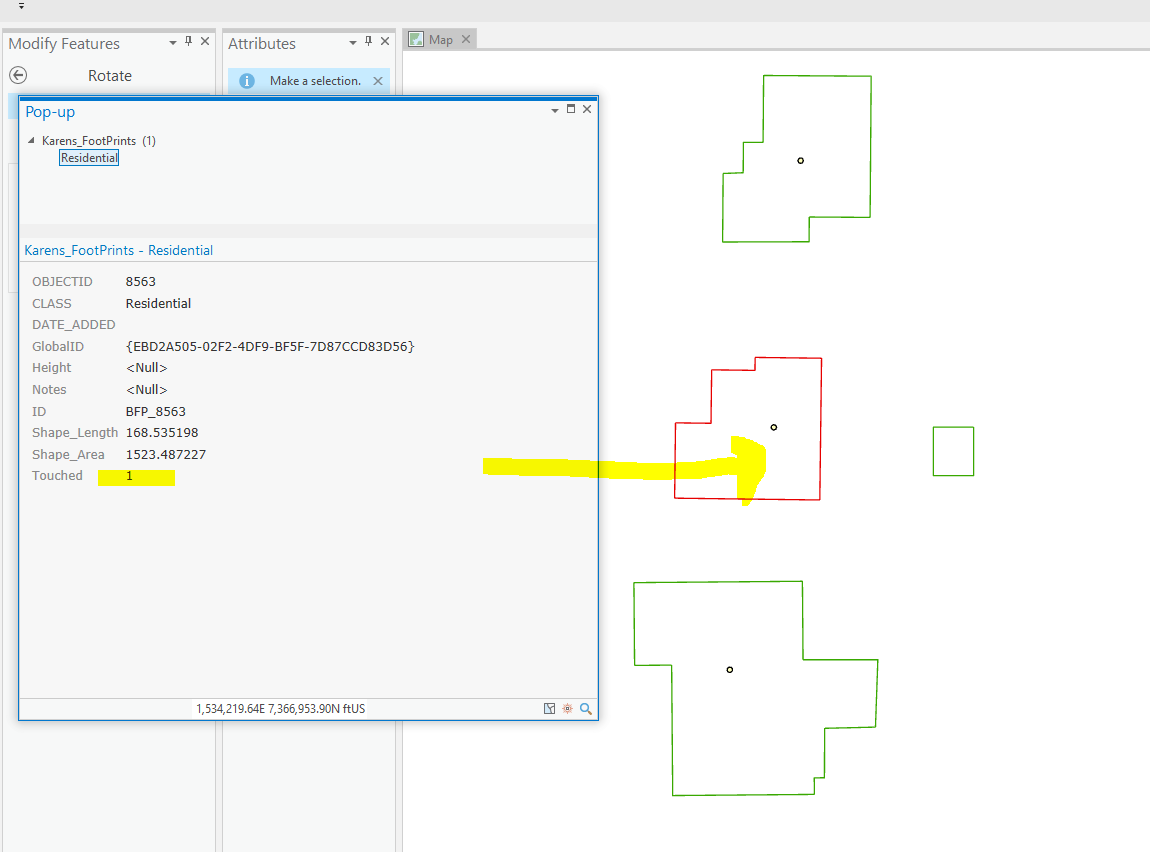

I'm experiencing some behavior while editing features in a FGDB that is somewhat annoying:  the features themselves are on the order of 17,000 building footprint polygons.  As part of my edit workflow, when the edit is complete, I update a numeric field from 0 (zero) to 1 (one).  The feature class is symbolized on this attribute which I call Touched. 0 = Red, 1 = green. (See image below).
The problem I'm experiencing is sometimes ArcGIS Pro will not honor the symbology change. In the image below, each of the footprints has been edited and the Touched attribute value = 1.  However, the highlighted polygon remains red.  I've also discovered if I uncheck the feature class to draw, every polygon turns off, except those that do not honor the Touched value symbology.  The only way I can get them to turn to green is exit and restart ArcGIS Pro.

Can you show how the symbology is set up on that layer?
What about cache settings on the layer?  What do those look like?
