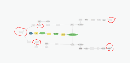

Hi,
I have a model that creates two buffers (100m and 450m). Each buffer zone intersects a Zone (polygon Feature Class) and summarises results per zone into two tables.

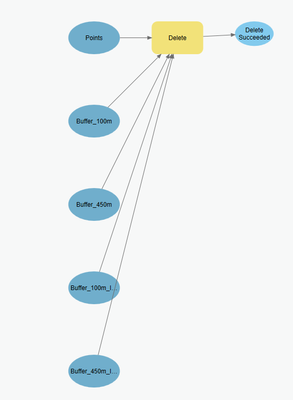

The second model that deletes buffers and summary tables
When I run first model, how to run second model first followed by first model.  I have raised it with ESRI Support. I just got only generic help.

I am failing to understand where to call second prior to running first model.
JayJohnsonWashoeCounty
A couple of different ways you can approach this.
1)  Don't break it into two models like that.  There is no real reason to have two separate models.  Take the operations you are currently running in model 2 and copy them directly into model 1 so that EVERYHTING is happening within a single model.  Then make all that stuff you just copied in a precondition.  That would force it to run first WITHIN that single model.
2) Alternatively, call model 2 as a sub-model from within model 1.  See this link for how to do that:  https://pro.arcgis.com/en/pro-app/latest/help/analysis/geoprocessing/modelbuilder/add-a-submodel-to-...
