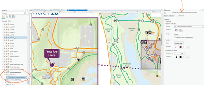

Hello ArcGIS Pro team and users-
We're looking for the leader lines to be dynamic in a map series when the extent indicator box moves around. Has anyone sucessfully used Inset leader lines in a Map Series? I haven't been able to find any resources out there for this behavior.
Thanks,
Amanda Huber
Amanda__Huber
MVP Regular Contributor
After more testing we were able to find the answer to this-
When adding an inset map in a map series, a sublayer within your map will display, you will need to turn it on to view:
Here is where you can control the appearance of the indicator and the appearnce of the leader line as well.
Hope this helps if anyone stumbles across this.
