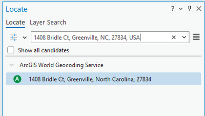

You can check the health of basic ArcGIS services at ArcGIS Online Health Dashboard. ESRI says that the Geocoding service had No downtime today. Most likely (if restarting ArcGIS Pro did not immediately solve the issue) is you had network issues connecting to https://geocode.arcgis.com/arcgis/ or your connection was blocked by a firewall.

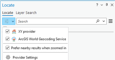

To check Locate setting click the drop down carrot to see what you have enabled.
EvaCordtz
I have the same options checked as you do; I did not change any settings, and I did not have these issues prior.

Hi Richard,
Thank you so much for your quick reply! Looks like I'm not able to insert photos into this reply, but the Geocoding Service works, I was able to replicate your screenshot.
