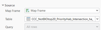

A similar thing is happening with tables. I want to put a table frame into this map series, and I have set a page query on the table to only show the rows that match the index field of the map series. I should have an option on the table frame element pane to select 'Visible Rows' as a query, but this is greyed out:
AubriOtis
For the table behavior that is expected. When you have a table frame showing data from a data table, not a layer, the query is always All rows. There is no visible data in the table so it can't show map frame rows or visible rows. Those are visual queries. Does that make sense?
